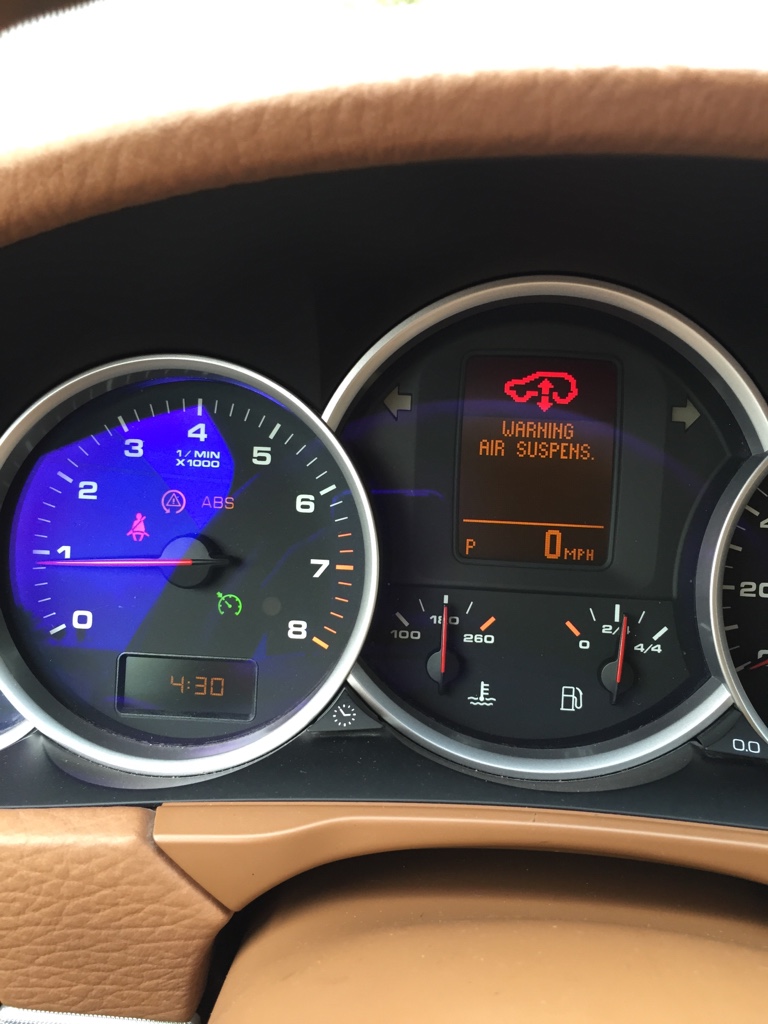

  13. Hi all I new to cayenne bought the truck a few months back ,fix all back up so far great truck , every time I start the car air suspension fault workshop,I've done the compressor piston ring and still I get the code on the selector inside It shows the different selection in the cluster but it doesn't raise or lower sometime I drive the back bouncy around real bad and rides horrible I don't have access to durametric so idont have any codes .thanks
