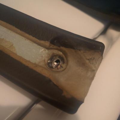

  2. Hi, I have successfully replaced 2 broken wind deflector roll bars mounting clips, using a new mount kit part 986-561-323-00. I had to drill the rivets out to put the new mounts in. Unfortunately, during the removal of the roll bar trims, one of them's screw broke. Anyone have any advice on how to re-attach the screw with a method which will be strong enough to keep the trim tight once re-mounted? Thanks a lot :)
