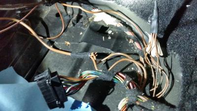

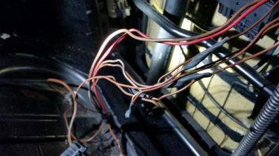

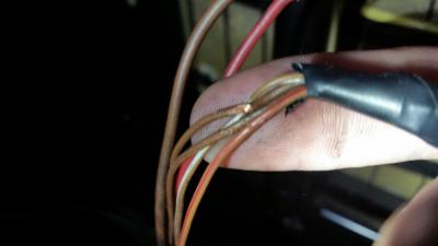

  7. I lifted the driver seat, and there was a decent amount of dust and debris. Also, it seemed like there was some electrical tape on the wires running to the drivers seat. Removed the tape to see if there was any major damage or what was the cause of the splice. Upon further inspection of the smaller wires. It seems like there has been some damage due to rubbing or catching. There was only two damaged wires. Perhaps if they were to ground out, it would prevent the windows from functioning. It is unknown at this point. It is important to note that the tape wrapping did not cover the exposed section of wire. Additional note, it seems like there was also some grounding wires that got a treatment as well. It has a Porsche tag on the new grounding wire on the right side of the image. My guess is that someone forcibly put the seat forward/back and then it cut the wires. This prompted the fix. I have sprayed contact cleaner on the connector and on the M535 unit. I am waiting an extra 5 minutes before vacuuming and putting it all back together. The M535 unit and harnesses looked acceptable. I did not see any evidence of wire exposure.
