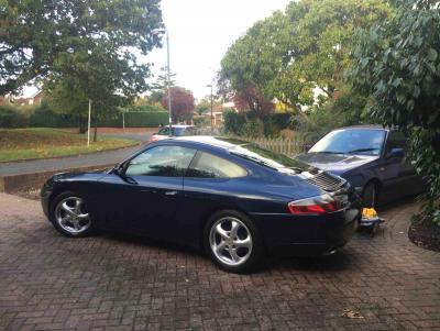

  1. Ok.... Have now managed to get the rubber grommet / end piece back up and out, but in the process it's come off the actual drain tube. Grrrr! Looking at the diagram the other end of the tube seems to emerge in the LH wheel arch. Is that the only access? Am I best off pulling the pipe out from that end and starting again? Thread resurrection- sorry! Exact same problem as 'le bouch' above. Grommet fell through, then disconnected from the drain hose while I was trying to pull it back out. UK car, drain to the right of the battery as you face it. Still haven't managed to pull the rubber bit back out. Even if I can pull it out, how am I supposed to connect it back to the drain tube/pipe?!
