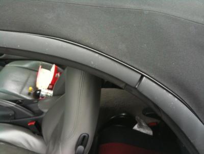

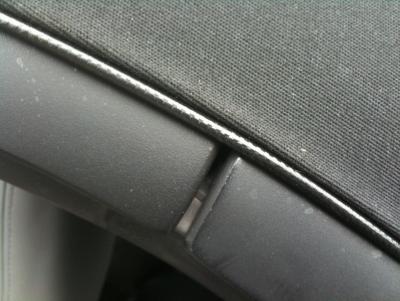

  1. I had a new Robbin's top put on my '99 996 Cab a couple of weeks ago. Looks great. We got some sun this week, so I went to lower the roof and hit two problems: 1) The top cover won't shut completely when trying to put the roof down. It closes completely on the passenger side, but not at the back and the right where it sits about an inch high after the complete cycle. 2) When putting the roof back up again the wires at the edge of the roof close *outside* the plastic arms above the window, not in the groove in those arms. See pictures. I took it back to the recommended soft top installer and he couldn't see anything binding preventing it closing. I've also looked at both sides and they look to be identical. So it is unclear why one side closes when the other doesn't. However, the roof when folded down is clearly a little (1/4"-1/2") high on the drivers (non-closing) side before the lid comes in to push it down and closed. Any ideas? Dammad.
