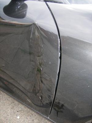

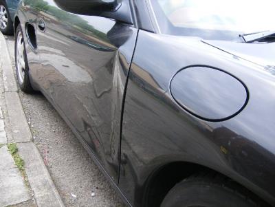

well, somebody driven into the car over the night, so will check the connectors in the same time as replacing the door, as it seams that it's much cheaper to get 2nd hand one then repair or new one.
That's bad luck, trey to find a 2nd hand door. It looks that the rear wing is damaged as well, is your car hit by a lorry?I can imagine how you felt.
Yes, that's what I'm trying to do, but no luck with black door so far.
Just blue or silver, so could somebody in UK with black 986 write it off, but leave the drivers door untouched :thumbup:
