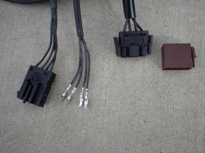

I am having trouble putting the 4 wires (green, black, Red, Black) into the plug B which plugs into my CDR23 head unit. These are the wires that go into slots 1, 2, 7 & 8 of the plug. Do I just have to push harder?
B Plug
If you have a CDR-23 then you have a 2003/4. If you have the amp in the front trunk you hook up the 4 wires to the amp. Not the back of the radio head.
This is the adapter that extends the cable and so you can plug the 4 wires into the amp connector.
Let me know if you do not have the amp in the trunk.
I assume you have the factory rear speaker kit. Plug in the brown connector. Then stick in the 4 pins with the correct orientation. They should just slide in with a click.
