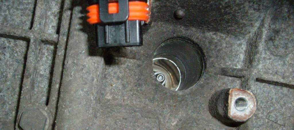

Several months ago on the Porsche Club of Great Britain message board a 2003 Boxster owner with a 2.7 posted this picture. He had cracked igintion coils. When he removed the coils he noticed that it did not appear that the engine had the black plastic spark plug tubes, and took the picture. For the life of me I do not see a spark plug tube in the picture.
The 986 Boxster never had VarioCamPlus, just VarioCam. When I look at PET it shows that the black plastic spark plug tubes are used on a 2003 Boxster. I do not see a gasket. Does anyone see a spark plug tube in the picture? Again, this is a picture of a 2003 2.7 Boxster.

The Boxster engines M96/23 and M96/24 2003 have no longer the plastic tubes and have nothing to do with variocam plus. You can check it in PET 7, this engines have other cylinder heads than the previous ones and other coils. The difference in coils is essentially the pipes that have an other design.
