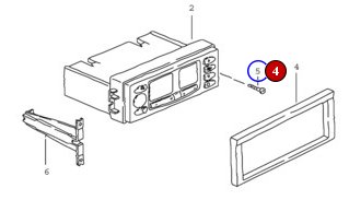

Does anyone know how the a/c surround trim fastens/clips into the lower/center console?
Mine is attached by gravity today. Tried double sided tape but there are not enough flat surfaces there.
I did an aftermarket HU install in my 99 996 and relocated my A/C controls to above the batwing.
The trim I bought was 996 552 339 0001 (looks like #4 in the attached diagram) but I can't for the life of me find the clips that this puppy snaps into.
On the back side of the trim there are two small plastic ferrules on either side, then in the console frame there are two small holes where it looks like some sort of small round clip would go into. Maybe a rubber grommet.
Is it OEM-191853615A Grommet, for, POS.4 ?
