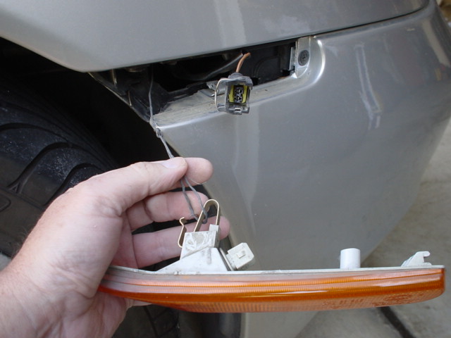

Inside the wheel well there's a plug next to the side of the lense, which you remove and then insert a screwdriver, to compress the spring holding the side marker in place, while you pull the side closest to the wheel well toward you. Do the same thing as you reinstall it.
