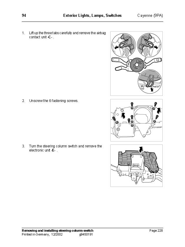

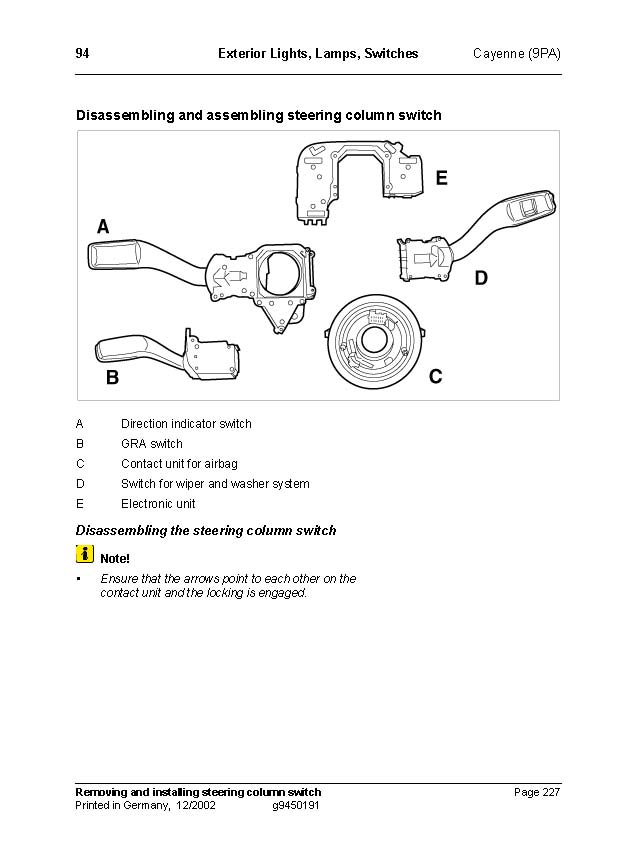

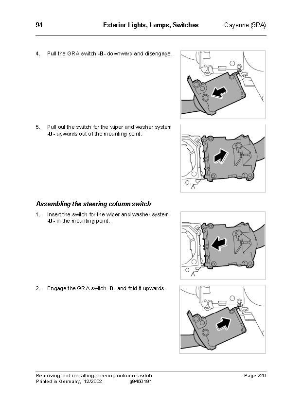

Well got the bits for the retro fit of the cruise system. From an 04 workshop guide it looks like you have to take out the signal/indicator stalk and attach the cruse to this switch then reinstall the two switches together. But I have an 05 Cayenne and don't know if there is any difference
Is it possible to take out these switches, without removing the steering wheel????
Just asking as I don't fancy mucking about with this (aribags & sensors etc etc...)

You have to remove: steering wheel airbag
steering wheel
trim
airbag central sensor
Now you got access to the stalk ( all other stalks can stay in place )
