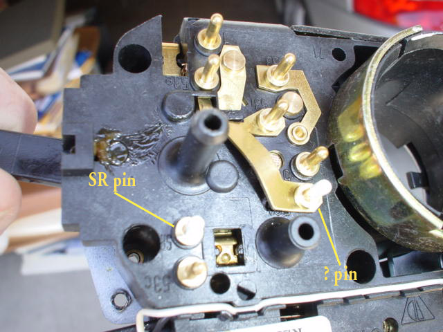

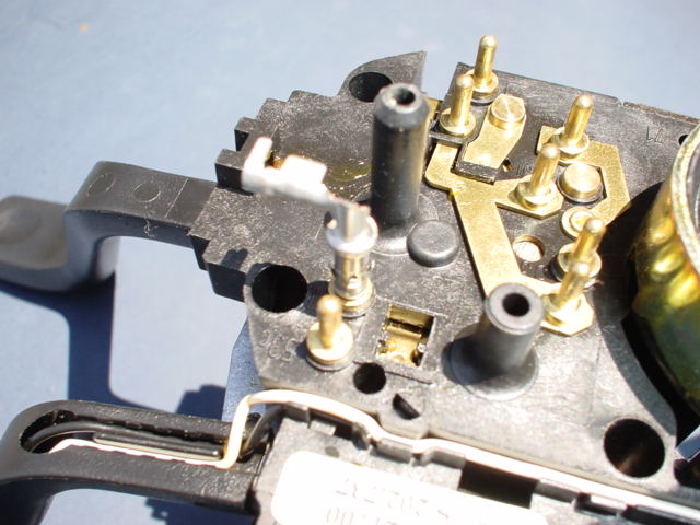

I am not the electrical guy, but 5 years ago I played around with the idea of using the wiper stalk to control something. One of the local EE Boxster guys did this to control some audio component.
From what little I remember there is an unused switch inside the wiper stalk unless the car has headlight wipers. That is push forward position you mentioned. I made some notations but it has been so long I don't remember. I even bought one of the pins that fit into the female electrical connector. It is the sliver pin in the 3rd picture.
