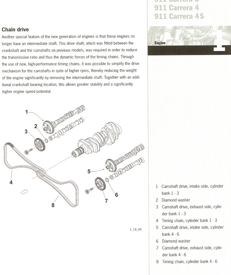

Is the new 2.9 and 3.4 now without intermediate shaft as per the 997 gen2 ? I thought the 3.4 was the same design just having DFI and new heads , is this not the case ? Information seems to be limited on what the face lifted cars motor is actually designed around.

no M96 engines are 996 engines.. M97 engines are 997 motors and they still have the "shaft"... (although built better... but still with the same possible failure points)

No :) They do not have an intermediate shaft. They utilize two chains off the front of the crank and run two cams per chain. One going to the right bank and the other going to the left bank.
(from the factory book released to Porsche techs before the cars starting shipping)
