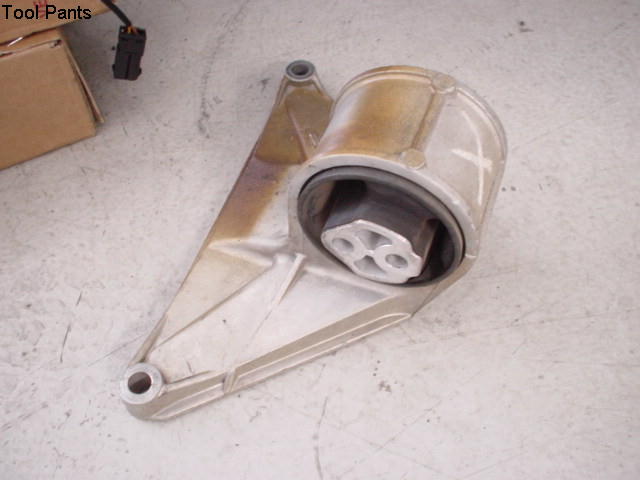

The powertrain unit has 3 mounts. The front of engine mount had problems with the early cars, and Porsche has changed the design. Rev up any car and you will see how the powertrain unit flexs a bit.
This is the front engine mount. The rubber bushing would slide out of the metal housing. This permits the engine to touch the body of the car and you get a vibration noise under certain conditions. You can see in this picture the rubber bushing sticks out past the housing. It should be flush with the housing.
You should get the car in the air and see if this has happened. The cheap fix is to remove the mount and press the bushing back in so that it is flush. Then drill a hole in the housing and insert a screw so the bushing cannot move. Dealers do not do this, as they simply put in the new style mount.
