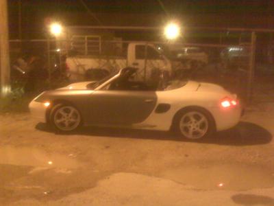

which damaged the drivers door, mirror and top pics can be seen in this thread i will be posting my work as it moves along
first thing we did was use aircraft paint stripper to get the door and fender down to bare metal
to nutralize the stripper you only need to wash the panel then dry and sand
after sanding the first primer coat was sprayed on 15 minz later the second coat
im sorry about the pic quality i left my camera at home so i used my phone, whats left to do now is disasemble some parts ie lights front/back, mirrors and a few other bits so that the car can be sanded down for the primer sealer then base coat and then clear coating all of this will be done in a day if all goes well. here is the car after the door/fender strip prime job
