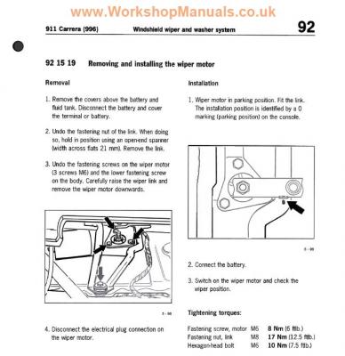

I need to replace my wiper motor. I have searched here and Rennlist and found no info.
My car is an 01 C2 cab with tip.
It looks fairly straightforward. I am wondering if anyone has done it, and has any guidance on the job.
Any and all comments will be appreciated.

Thanks Paul,
This does look really easy. I wanted to make sure I didn't run into something unexpected.
