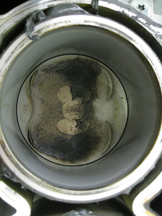

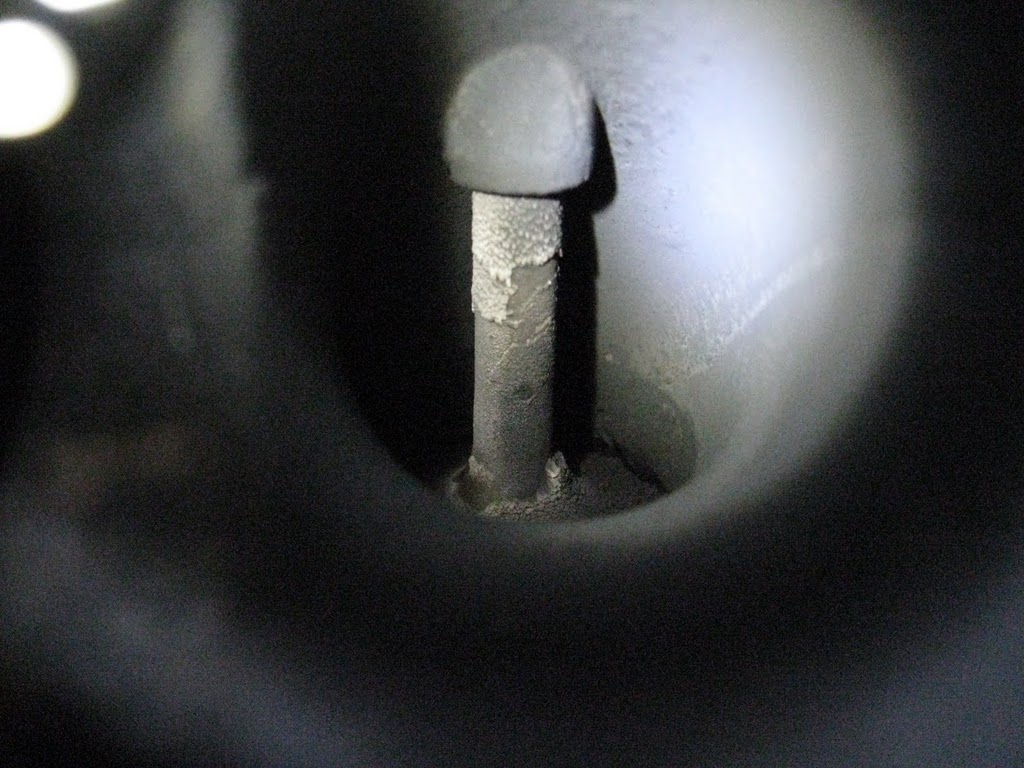

Sorry I'm not sure if I have those pictures I probably deleted them. I did take some but they were out of focus or the exposure was bad.
Bank 2 generally had less carbon than bank 1, and mirrored what the plugs looked like.

bank 1 before engine removal (with 75k on the clock, presumably set by the factory)
bank 2 before engine removal
