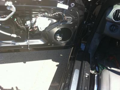

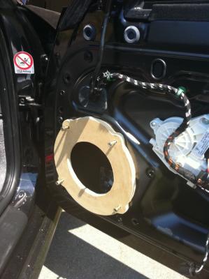

Thank you for an amazing post in this forum, I was able to take the door panels off with EASEEE. Once I had them off, I was able to see what I was dealing with. I believe the factory Mid-Bass/Woofer is a 7” speaker mounted into a plastic, molded grill (Mounted to the door). Then there is a 3.5” speaker that mounted on the door panel. Finally there is a 1” tweeter mounted on each side of the dash. I will not be using the factory tweeters or center channel (in the middle of the dash). The hole for my 6.5” boston Accoustic woofer is too big so I took the plastic woofer housing and traced the pattern onto a ½” piece of MDF. I also centered the traced the Boston woofer onto the MDF. Cut and sand... Cut and sand, Cut and sand... BOTH SIDES.

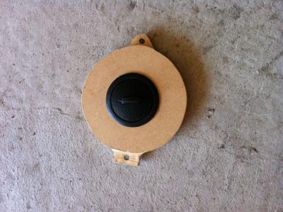

The Tweeter took a little more thought and design. Once again I traced out the OEM housing onto a piece of MDF. The trick here was to make sure the MDF cut out laid flat in the door panel. There are 2 screw tabs that are raised which meant I had to cut more than just a 2 dimensional piece of wood, but now accommodate for the height. I highly suggest you buy, borrow, steal a dremmel. As you can see in the pictures, I cut the tabs down.
The next step is important if you really care about your sound. You don’t want rattling from your door panels when your speakers are playing lower, punchier frequencies. Use some sort of sound dampening material. I used Dyno-Mat. The truth is I would have used HushMat, but the store that I buy from was closed and this is all I could find. It is still functional and does its job.... It is just a preference. (I will open up the door panel again and HUSHMAT the rest.
First, I put Dyno-Mat around the opening and then covered the woofer MDF panel. I screwed the wood in, turned on the radio and cranked the bass. Now I was able to hear and feel rattles and vibrations in the door. I put Dyno-Mat on those spots. (It’s also important to DYNO in the door, On the magnet of the speaker and behind the speaker). At the end of the day, you get clear, crisp sound with no rattling.
