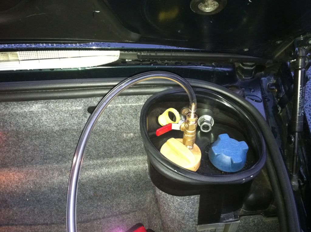

I recently used your DIY and created my own AOS tester. Here is a shot of an adapter attached to my oil cap.

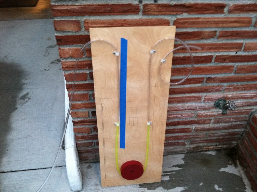

Here are two photos of the air tube with one end attached to the oil cap and the other to the gauge.

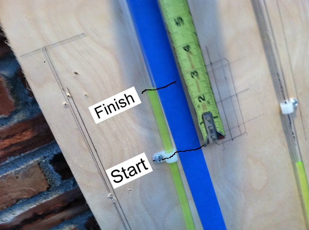

I marked the start and then the finish after opening the valve to the oil cap.
