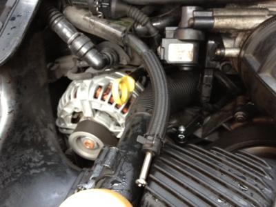

While cleaning my Throttle body on my 1998 Carrera 2 I managed to brake this little plastic joint pipe, looked on diagrams but can't work out what it is, anyone know and what the part number is.

I broke one while reinstalling my engine.
I temporarily put it back together using a 1/4" hose repair kit from home depot.
Then I bought two of the real thing, one to have as a spare.
Porsche P/N 99610622652
About $5

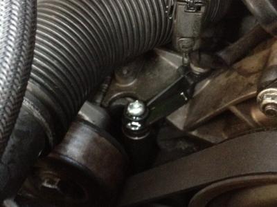

Logray, I broke the same hose while doing alternator. I cannot reomve the bottom part the the connector as it is locked tight with gold metal fastener that has no way of letting it go. Please help

2002 C2
