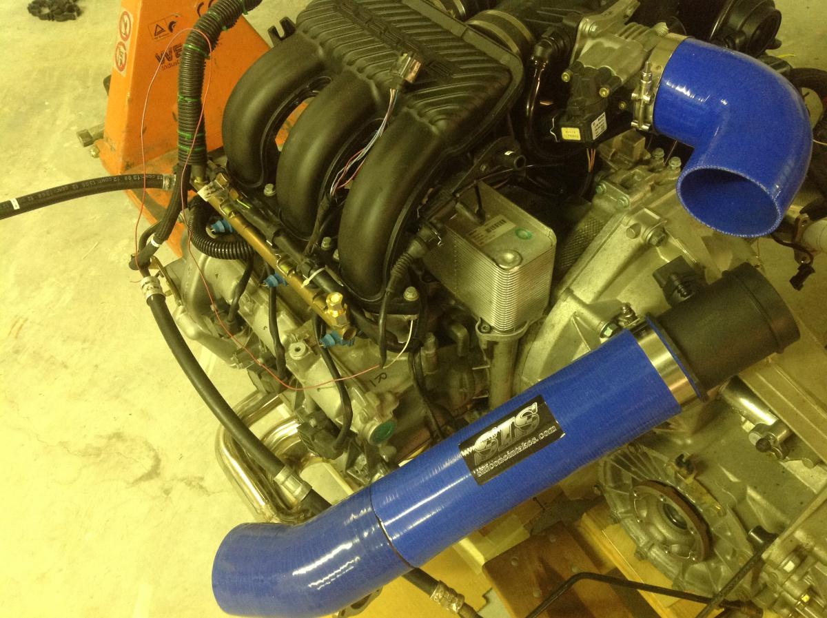

Down to final steps of a 3.4 swap into my 1998 Boxster ( including a 6 speed trans).  I have a number of questions I hope someone can help me with or answer for me.
1.  I have enclosed a picture of my exhaust headers.  Note the inside diameter of  58 mm.   Also note my fabricated intake manifold (Blue silicone piping)  3 in. ID.
     My question is how far away from the throttle body should my MAF be placed??   I am using a BMW MAF holder (black tub)with a Porsche MAF.  Should this BMW tub be as close to the throttle body as I can get it or much further away as it is in the stock Boxster close to the air box??
2. I would like to fabricate a pipe to eliminate my CAT.  If I do this can I eliminate my post CAT sensors??
3. The stock DME is Motronic 5.2.2 and is the same DME model that was in the 996 the motor came from.  Will I still have to flash the DME before the car
    will run??   I know if I drop the post CAT it will need a special chip what if I do not drop the post CAT ??
