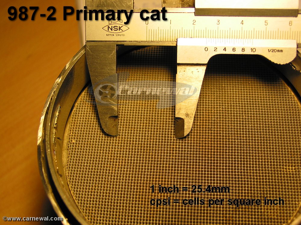

The 987-2 primary cats are 400 cpsi (cells) not 700 or 800. (see picture bellow)

This is the primary cat of the 987-2 exhaust system.
Count them yourself :  20 x 20 cells per inch = 400 cpsi and not 700, 800 or ....
