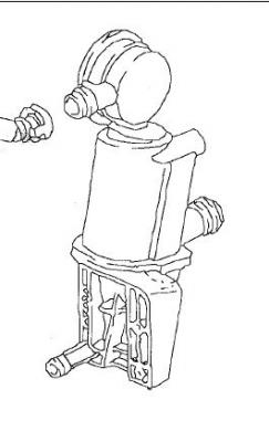

I pulled the short hose connecting the oil vapor separator to the intake
and there's liquid oil in the hose. Is that normal?
next I was going to remove the throttle body/intake and see how
much oil is laying around in the system.
I don't know if the separator is not working right, or the oil is just normal accumulation
from 5 years of vapor condensation. Any way to test the separator or other suggestions?

conclusions.....
I cut open the round top of the separator. Inside is a diaphram and restriction mechanism. It appears the purpose is to throttle the air flow through the separator when the intake vacuum goes up.
Assuming the tear I found in the diaphram wasn't created by my chopping the thing open, the symptoms are all explained.
The tear acted like a vacuum leak to the intake, hence the lean condition and codes P1128 and 1130. Since the diaphram mechanism was not blocking the vacuum, oil was simply sucked into the intake where it puddled.
The oil vapors that accumulate after engine shutdown burn off when the car is started again, resulting in a rather impressive smoke-screen.
