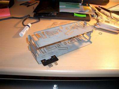

This is a common upgrade because the 220 has aux-in unlike the 210. Otherwise the performance of both radios are the same. I think the harness is the same. The mounting housing for the 210 is removed because it is not needed with the 220. You also have to do something with the alarm contact for the radio.
I am starting to forget old stuff so do not trust my memory, as this swap started years ago when the 220 came out.
I think the alarm contact for the 210 was on the mounting housing which you need to remove to install the 220. Or something like that. Back then most people removed the 210 housing and just put tape on the end of the wire to the alarm contact so that if the end of the wire happen to touch ground you would not get the single beep when you set the alarm. There was info on the old Becker board.
Also look at the Traffic Pro TSB as it mentions the alarm contact.
Who would ever steal a Becker radio? Back then people who did the 210 swap would just put tape on the end of the wire and forget to incorporate the alarm system into the 220 radio.
Get your 220 radio first and then I will see if I saved the old info on this swap.
This is the 210 bracket.
Jeff - I did the 210->220 swap in my '98 and your information is correct. I got the alarm beep until I taped the end of the alarm wire. The important thing is to realize that the metal bracket for the 210 is not needed with the 220. :D Once that bracket is removed, the 220 slips right in and the old connector plugs right in.
