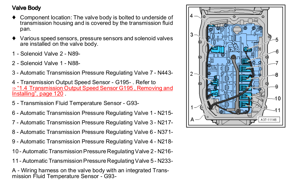

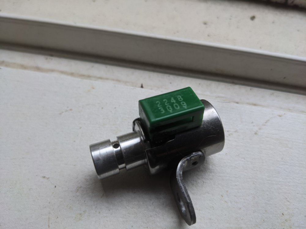

My N89 solenoid shorted inside (coil melted?) and I need to find a replacement. No matter how hard I try, cant find part # or part itself. Lots of similar solenoids from other Aisin transmissions, but not exactly like it. In attached images is the location of same solenoid (1) and solenoid itself that I removed today.
There are following letters/numbers on it:
2248
3G09
all searches fail. May be this is part #? I bet not...
