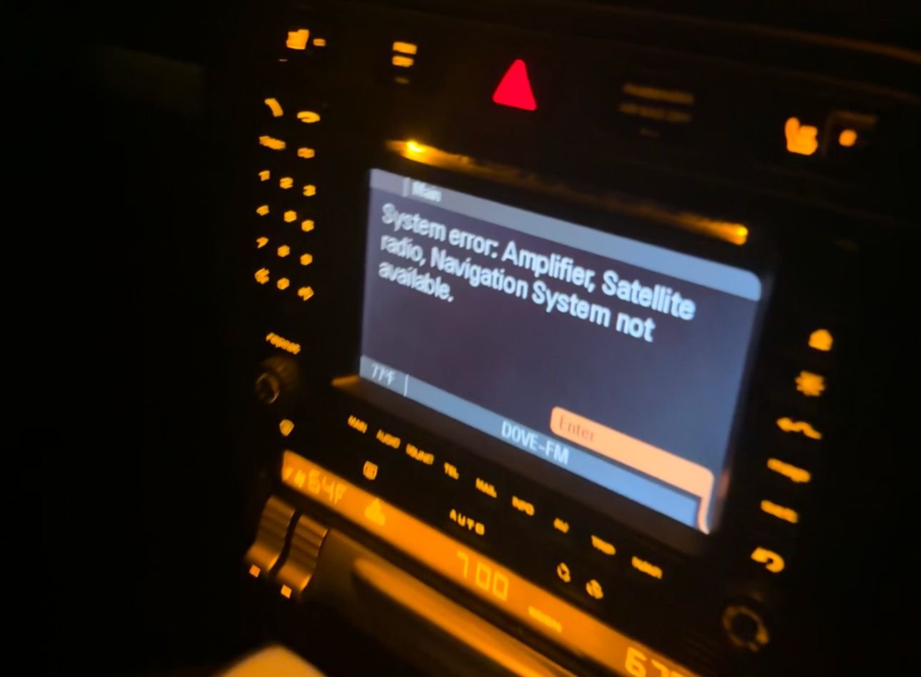

I’m trying to diagnose an issue in the MOST loop on a Cayenne S 2008. I’ve tried the bypass loop tool on the Nav drive and on the amp . I’ve also tried a new amplifier as well. But to no avail.
The only part that remains is then XM/satilite radio module . I can’t seem to find it , I’ve read it’s under the rear seats but I don’t see anything?
Any ideas ?
attached is a pic of the system error on the PCM screen.

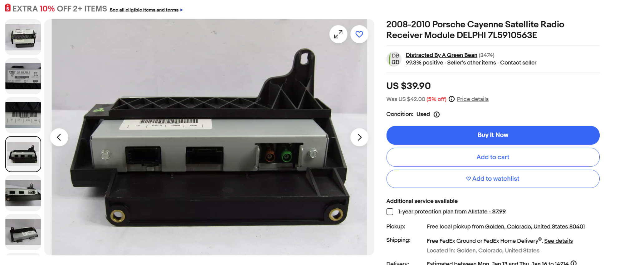

To add, Im trying to locate this below module:
So if not under the passenger seat or the rear seat, where would this be located?
