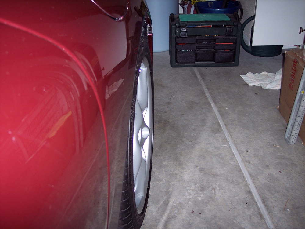

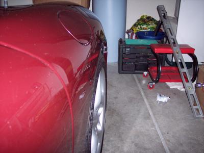

Subtle, but still noticeable. I didn't take any pics of the rear though. Somebody over on Rennlist though posted pics of his 17mm spacer on the rear runnning with a 10x18 rim and 285 rubber. STUCK OUT! Didn't look good. My suggestions is either the factory 5's or aftermarket 7's.
It all depends on what offset you are starting with on the wheels. LV, your front wheels look like they stick out a lot more before the spacer than turbo-twist-look wheels that came stock on my car. What offset are they?
