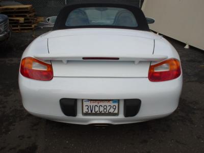

Question for you parts experts about the trunk - I seem to recall seeing a smooth trunk installed with the rear spoiler, as the spoiler has an integrated brake light. But I've also seen the third brake light blanked out with a piece of plastic.
Do you know if there is a trunk that does not have the brake light indentation? If so, what is the part number?
Here is Den Vogl's car with the plastic third light blank
Thanks in advance!
With the original AeroKit you got a new plastic trunk lid that was longer to cover the gap where the electric spoiler was. You need to remove the electric spoiler with the original AeroKit. The lid is 986 512 991 00, plus maybe an extension code for primer. There is also a black plastic blanking cover to cover the gap when the spoiler is removed - otherwise you would see a hole where the electric spoiler was when you lift up the plastic trunk lid.
