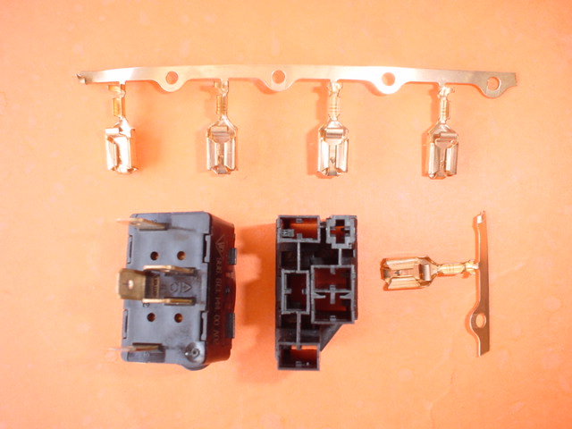

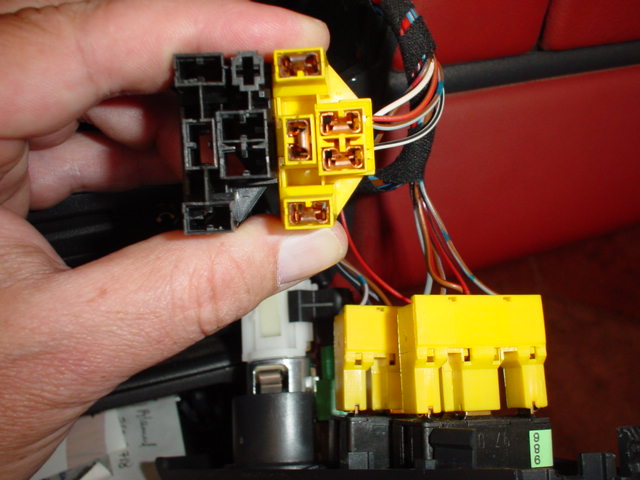

There are many part numbers for a plug that will go into the back of the switches.
I went the cheap way and got the VW version 3 years ago.
Plug/housing was 8N0-971-636. This is a VW part number.
Female spade pins were 999-650-103-12, and the most you can put in the plug is 5, because there are only 5 lugs on the back of a switch. This is a Porsche part number.
Total cost 3 years ago was $4.
