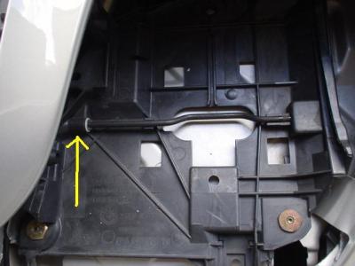

The left hand headlamp assembly just will not lock in place.....
The right hand unit slides in perfectly and easily locks with audible pop. The left hand unit fits correctly and a partial turn of the locking tool will produce a popping sound. The assembly appears to locked in place but just a slight finger tip lift of the leading edge of the turn signal will cause the unit to slide out !
I have repeatedly checked the headlamp assembly, mounting plate, assorted alingment channels etc. All appears normal and nothing is broken.....
Any suggestions as to something I might be missing? Is there a way to adjust or "tighten up" the locking mechanism??
Car is a 2003 Boxster with Litronics. This problem probably will covered by warranty, but it is a 60 mile roundtrip drive to the dealer.

Sometimes the tool is a sloppy fit and the pop you hear is the tool slipping. Try a 5 mm socket instead.
Check the mounting plate in this area. I have seen 2 cars and the plastic was broken and the light would not lock.
You are absolutely correct. The problem was the "special tool" provided with the car.
A simple twist of a quality 5 mm socket solved the problem in less than two seconds.
