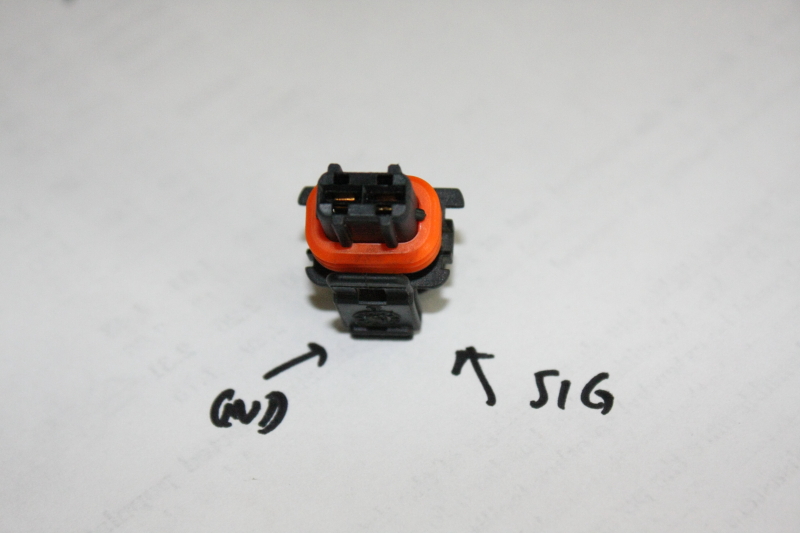

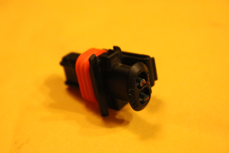

I had been getting a P0327 (knock sensor circuit bank 1) code on my Boxster, and today I had time to investigate. It turned out that the wiring to the knock sensor was completely severed at the connector (see picture; this is the connector on the engine harness that plugs into the knock sensor).
How do I best repair this? Can these connectors be bought somewhere?

It will be possible to push the pins out, split open the crimp and insert a new length of wire (say 2") and recrimp them. Then solder to the wiring in the car and cover with double wall heat shrink. If what I have just said scares you, then perhaps repeat that to an automotive electrical guy or even a car stereo installer.

Thank you! I think I'll be able to do that.

But I think I've figured it out. I traced the wires on the other knock sensor back to the DME. There are separate pins for knock sensor signal and knock sensor ground on the DME, so the polarity must matter.
Incidentally, I was wrong in my previous post; the DME pins I mentioned are for 97-99 Boxsters. For my 2001 S, the pins in question are on connector C at the DME (just in case someone else comes across such an issue in the future):
pin 36: signal knock sensor 2
pin 37: ground knock sensor 2
pin 49: signal knock sensor 1
pin 50: ground knock sensor 1
Based on tracing back the wires, the signal / ground pins on the knock sensor connector are shown in the picture below.
