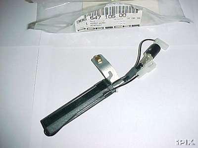

I can't remember what sort of plug it was but from picture four in my photos here http://lawlai.com/album/thumbnails.php?album=13&page=1 it looks like you may be right, certainly doesn't look like the euro connector. But this is the AM antenna - does that matter? Do they share the connector? I thought the FM antenna was in the windshield glass.
I think if it were me I'd get the adaptors and connect behind the head unit, it's much easier and they're only $20.

The am/fm antenna is in the glass. The thing in the A pillar is the electric booster. Here is an ebay picture of the booster.
