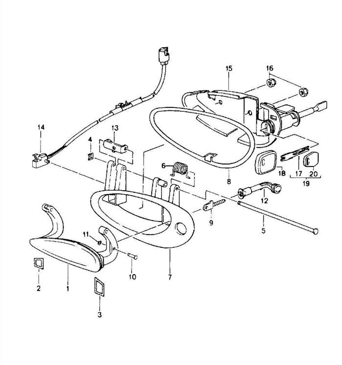

I have a 2004 Boxster S. The key fob will not unlock the doors (although it will open trunk and hood). Inserting the key in the lock will not unlock the door, and outside handle will not open door (yet inside handle does open door). Any suggestions? Thanks.
this doesn't sound like a snapped bowden cable ,since your inside door is working.
It is most likely the door lock cylinder needs to be replaced,,,
U can order the CODED lock cylinder if u have a key code+stated lock code.
refer to #15
