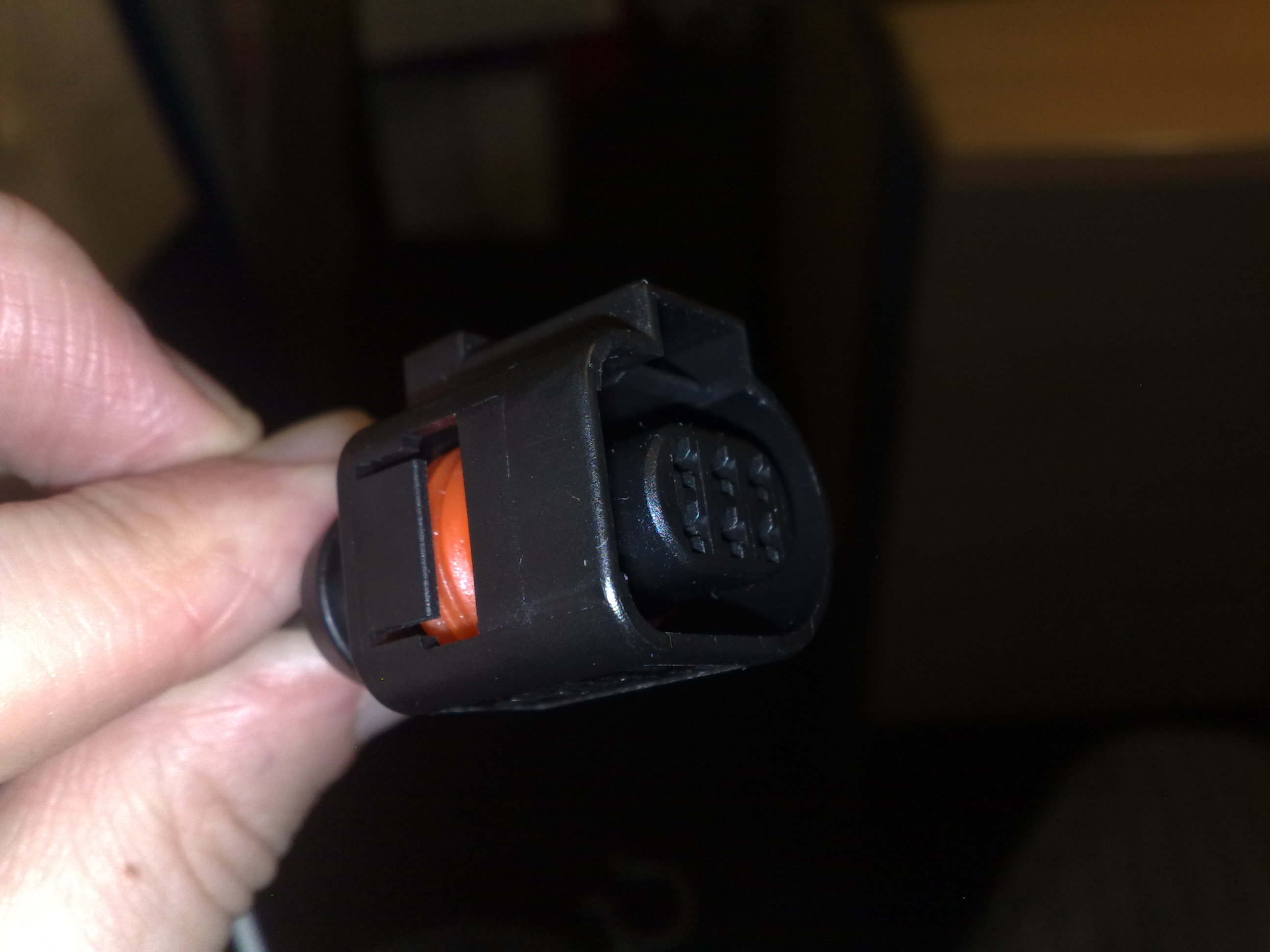

i purchased a front turbo loom (front bumper loom) hoping i could just plug and play however there are no plugs for the 2 led control units ( 997.618 201 00). opc told me that they plug in to the other loom in the trunk or will need to be hacked in, have you any idea where i need to hack, and also where i might be able to get hold of a couple of plugs to plug and play, they have a vw audi part number 1J0 973 713, (have attached jpegs) and plug in to the led control units,

Hello everyone, quick update, managed to order some plugs direct from VW so hopefully will update you when they arrive however ive not had a single reply to my question of how to retrofit, surely somebody somewhere must have done this conversion, i just need to know where do i connect the led control unit to, please please please help, got all my parts and i just want to get them fitted, Tim
