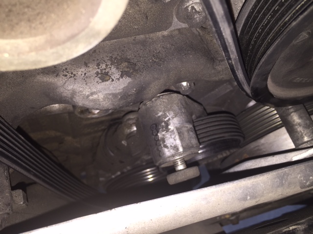

  1. All of my accessory and crankshaft pulley's seem to be in tact. Wondering, if through some research, the loud pop I heard was the high pressure relief valve of the AC unit. Can anyone comment on whether or not the tensioner can simply fail on it's own? Could it be possible this is all I need to replace, and would anyone care to comment on a DIY or if the engine needs to be lowered to accomplish? Thanks in advance!
  2. Thanks everyone for your reply's. I have been traveling and for whatever reason, have not been getting notifications on your postings. slicky rick, your assessment is correct. The tensioner is no longer in the right position and the tensioner pulley has dropped down to the lower right and wiggles excessively. The hydraulic pulley (red arrow) is the only thing in place right now. The bolt within the 24mm section is loose and can pull out. Something has caused this to suddenly occur. I was sitting stationary with the AC running in 105 temps for about 10 minutes. I wonder if my AC compressor seized? The AC pulley still turns, as do all of the other accessory pulley's. Surprised the belt did not break with this, but something of force caused the bolt holding the water pump housing to the engine block to shear the bolt to the left of the yellow arrow. Can it possibly be that all that needs to be replaced here is a new tensioner??? I see no DIYs on this either...
  3. Guys, Was waiting for my son this week in hot weather with the AC running. As we left our destination and I began to drive away, I heard a loud pop, followed by grinding and squealing. The battery generator warning light came on and being only 2 miles from home, I shut off the AC and made it to the garage. Upon inspection, my serpentine belt is fine, but I have an obvious problem with the tensioner. I have searched this site and the internet for a DIY. Anyone have anything they can share? I am thinking in need to replace the tensioner completely. I also, reluctantly, noticed what looks like a sheered bolt. (pictured) Would appreciate any input!
