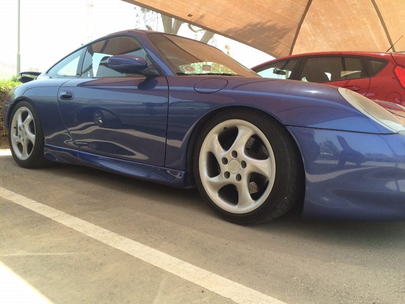

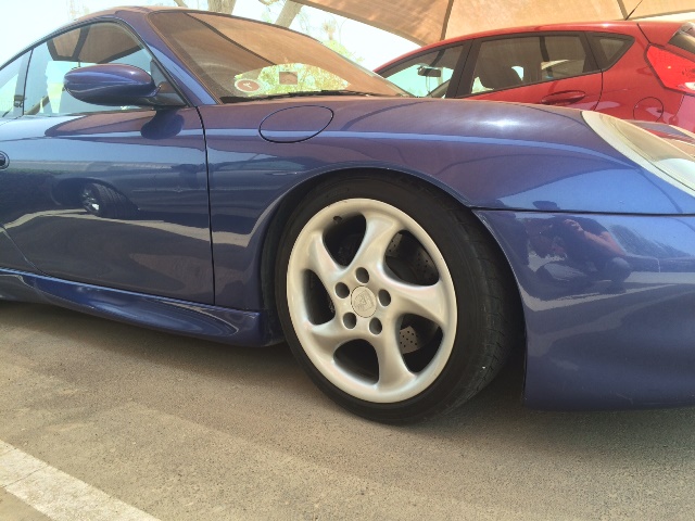

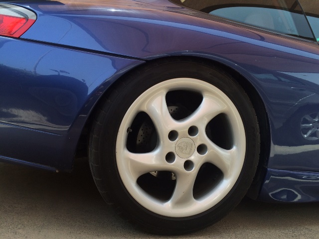

  11. Thanks. Guess I need to get back under there and look more closely the the springs. Hopefully I can find some markings.
  12. Ok. I measured the ride height at the bottom of the car. I am 4in (101mm) in the front and 4 11/16 (119mm) in the back. So I am sitting about 40mm less than stock. I pulled the front wheel and the shock part number is 996-343-041-04 which is the stock shock for my car. Soooo... when I go to order new shocks should I order Bilstein B6 for normal springs or a B8 for lowered springs? The service manual says there should be colored bands on the spring but those are long gone. Any guesses?

  15. Hello. I have a 1998 RoW Carrera Tiptronic. I purchased used from a dealer about 2 months ago knowing there were a lot of upkeep issues. I am looking at updating the suspension as there is a clunk in the from end going over speed bumps. The OPC says new wishbones, control arms, shocks all around. Based on the age that is probably a good idea. The maintenance history is spotty and the OPC in Bahrain is the only one in the country. There are quite a few Indy's though happy to work on your car. Looking at what other people have posted about their fender height, mine seems way below stock. The fronts sit at 24.5 (622mm) and the rear is 25 1/8 (640mm). That is with a 1/2 tank of gas and nobody in the car. As I am looking to replace the shocks and reuse the springs, after I pull the wheel off, how can I tell what type of springs are on the car? I imagine I should be able to see a serila number on the shock itself and that should give me an indication. Can anyone tell me if I am heading in the right direction or if I am way off? Thanks. Couple of pictures below.
  16. Unfortunately, I do not think Bahrain is in your neighborhood. I do appreciate the offer though. I may try and find an Indy here that has one.
