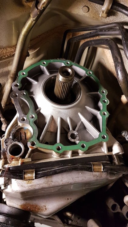

    911 Carrera 4 (996) Cabrio

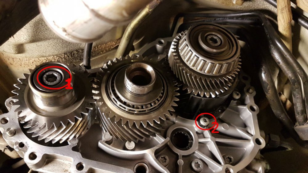

  2. Thanks Loren That was a great help, I'm now at the stage shown in the picture Do you have the torque for 1. Holds the left and right gear...currently @ 39lb ft 2. Holds the plastic oil tray underneath the gear...currently 10lb ft and by the way many thanks Managed to slice my thumb putting the gears back on.....
