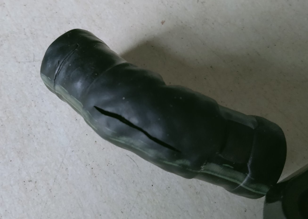

  1. Just before you rush off to buy a new pump please check the pipework inside the fuel tank. The two small rubber hoses often split and cause intermittent loss of pressure. Not easy to see but attached picture shows the problem, E10 fuel in the UK and Europe affects both rubber hoses and they should be replaced with the correct type of fuel submersible hose. It is very cheap £5 GBP per metre and easy to fit. (you only need around 20cm) In the UK it is available from Halfords and other outlets such as NAPA in the USA.
