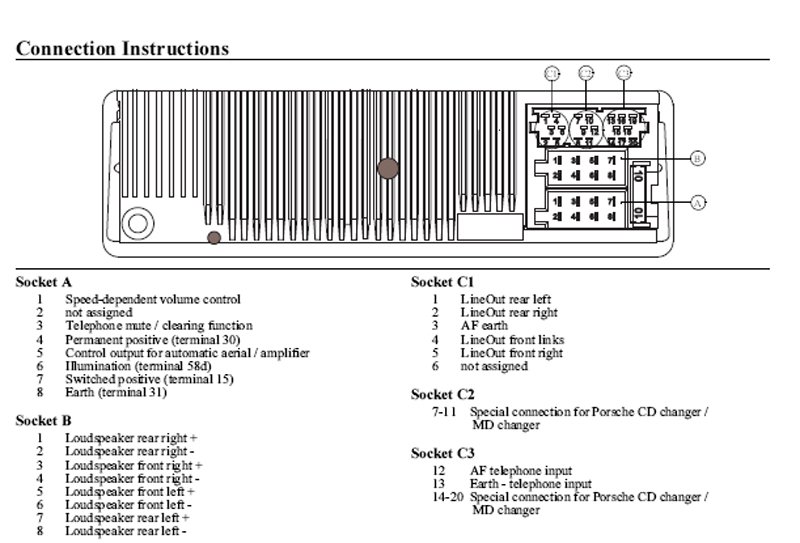

  15. Hey Man, Work from the CDR-220 wiring diagram. (see attached). I used this same adapter. The red harness is to connect C1,C2, and C3 from the OEM CDR-220 connections to the aftermarket radio. This will provide you with RCA preamp and amp on/out connections to the aftermarket headunit. The back harness from CAI is for sockets A and B. Good luck!
  16. Ok, not a problem.The Metra kit you attached looks correct. I have basically the same thing in my 996. But remember, the Porsche (Nokia or HAES) amp in the frunk is a 6 channel amplifier. The CDR-220 provided the amp with 4 preamp signals that are distributed across all 6 speakers in your car. As you can see on the wire harness on the left, you'll need to connect the 4 stereo RCA preamp connection to the Pioneer. The blue cable is for the amp switched 12V signal to tell the amp to turn on and off. Normally, you connect that to an aftermarket radio's antenna output. The Pioneer 80PRS does provide these necessary RCA outputs and so you're good there. Good choice.
  17. Are you changing out the head unit and the amp? What system do you currently have in your car? CDR-220? Nokia/HAES amp in the frunk?
