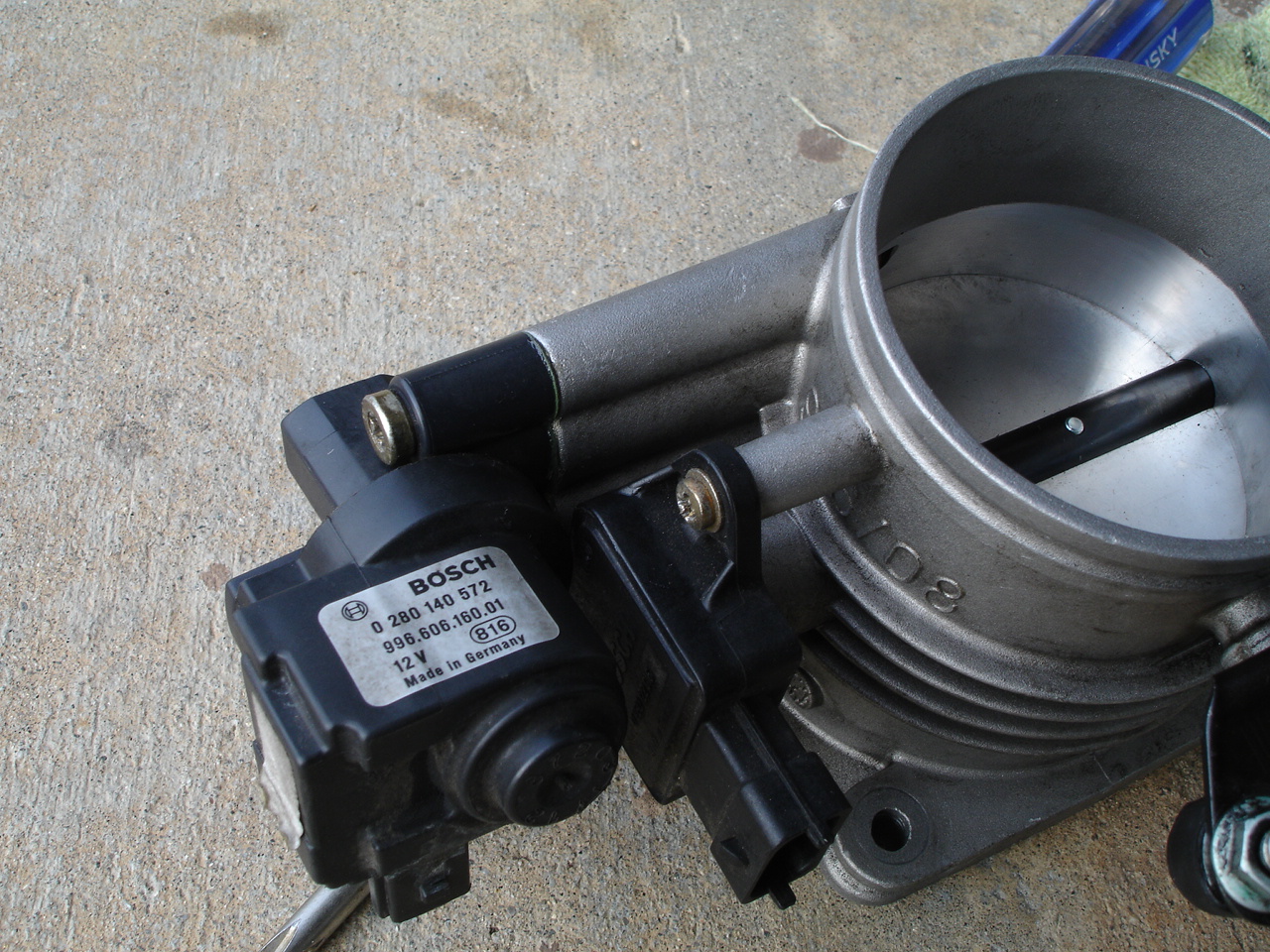

  9. After a long process - changed MAF, Speak plugs, Speak boots, O2 sensors and ...etc... problem seems resolved by trauh's way - Tightening the throttle air intake bolts. CEL not back for almost one month 1000mils. it must some please has vacuum leak. And now the car seems more smooth and has better gas mileage.
  10. Tight the throttle air intake bolt work for me, the CEL light not back on so far. Thank you for your hint Trauh. :drive:
  11. Hi trauh, I have the simillar problem and want to know where is the throttle air intake bolts locate? Thanks, Tt
