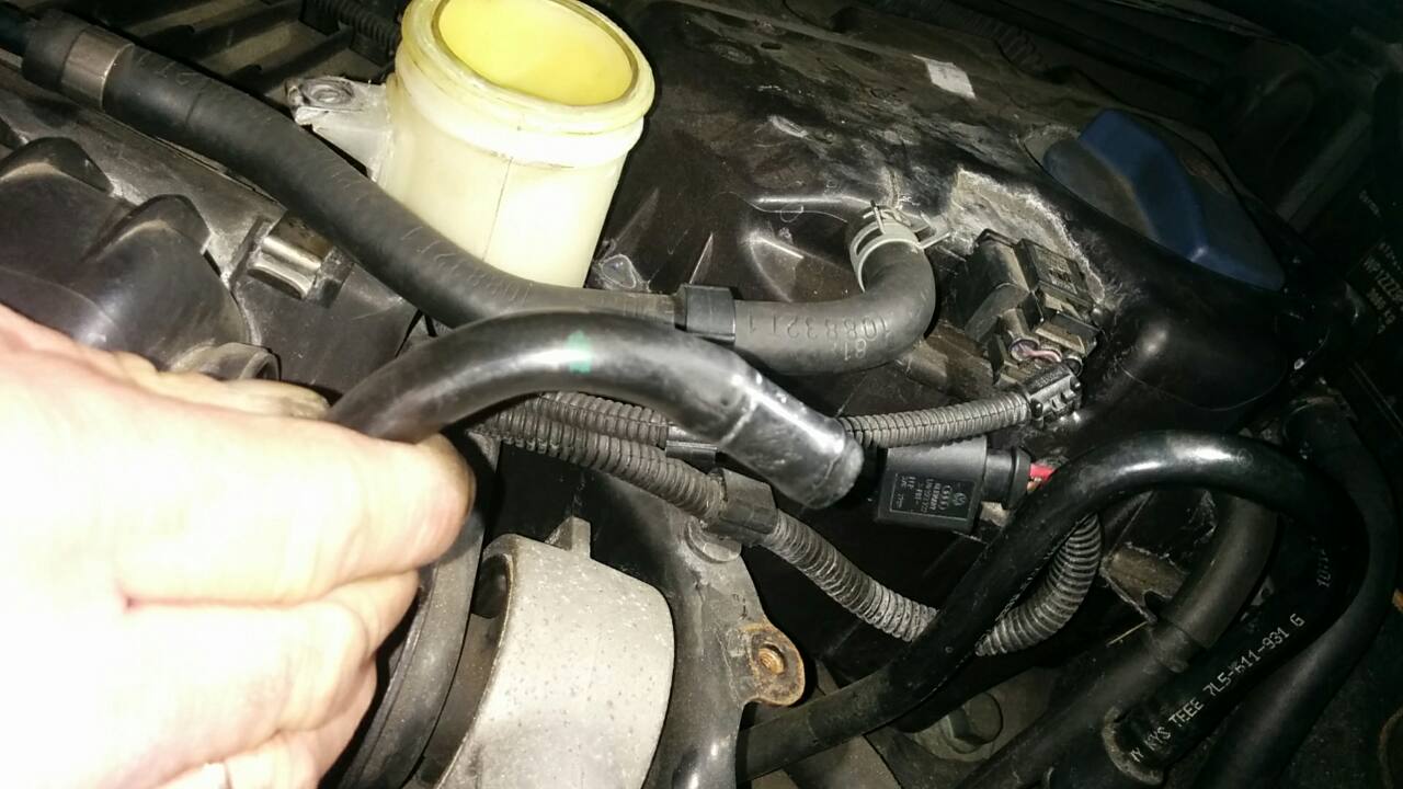

  1. You're not gonna believe this. I think I've found it !!! it was almost invisible but a quick blow job lol indicated the split might be hiding under this rubber hose.. got that welded, put another hose over it and the fault cleared.. fingers crossed !!! going to contribute to this forum for sure . sorry had few shots of jack daniels to celebrate no lights warning on dashboard after 2 years of trying lol
  2. Makes me think my mechanic might not even know how to do the smoke test.. I'm determined to get this fixed and will probably take the booster pump off myself to see what's hiding there.. There must be a split hose somewhere !!!
