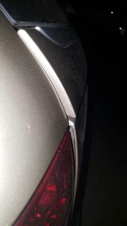

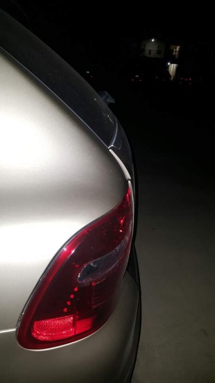

  1. My rear hatch doesn't close completely. Latch on bottom and latch on door works perfect. When it closes, the system think it's closed. no light on. The issue are it looks ugly and come out cold or warm air from it when a/c or heater are used. Is there some way I can adjust? I tried to unscrew bolts and adjust both latche positions but no space to move around either bottom or door latch. Is there some way I can adjust?
