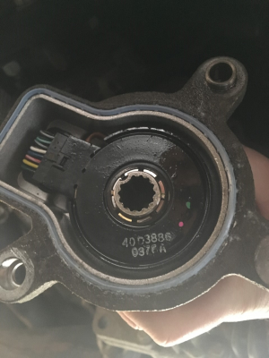

  1. My transfer servo appears to have died, leaving my car stuck BETWEEN high and low drives.... the car is rolling in park with no drive to the wheels when in gear. I'm going to take the servo off and manually turn the shaft to put it into high. I'm going to need to put back the faulty servo until the piggy bank is full enough to buy a replacement, so to turn the motor Im going to buy a splined socket and grind off a couple of teeth, does anybody know the diameter of the shaft? Ive stuck a pick on of the servo/shaft position.... Thanks Jonny
