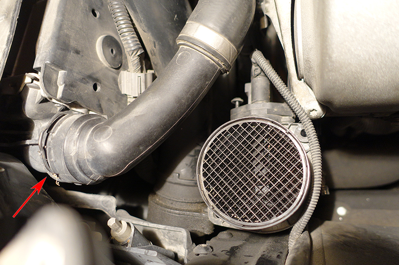

  4. I didn’t think about heating up the pipes – good idea, thanks. After some more work, the MAFs are finally cleaned and everything is all back together again. Classic 1 hour job that takes 5 hours! But to wrap this up, I thought I would post the results. Before/after observations, although the after has only been for about 40 minutes of driving. 1) Before there were starting problems – up to 5-10 seconds of cranking when cold to get it to start. Tested this twice so far, each time it started instantly! 2) Before there was an unevenness between left and right exhaust. Seems better now. 3) Before the idle would randomly get rough – after it has been smooth at every stop light. 4) Not much change in overall power 5) New behavior when the engine drops down to idle. Before it would go smoothly down to around 550-580 rpm. Now it dives down to 400 rpm, then picks back up to 550. Sounds like I should also clean the throttle body now? Or maybe it needs to adapt again... 6) Right after cleaning, I was freaked out because it was running like crap, backfiring and coughing on the driver’s side. After running it for a while in the morning, that was all gone (big relief!). So as it is maybe one of the last nice days here in Alberta for the year, going to try and get out for a run in the mountains today. Believe it or not I just learned what turning off PSM really does (I thought it was just regulating the suspension). Need to play around that a bit. Thanks again for everyone’s help.

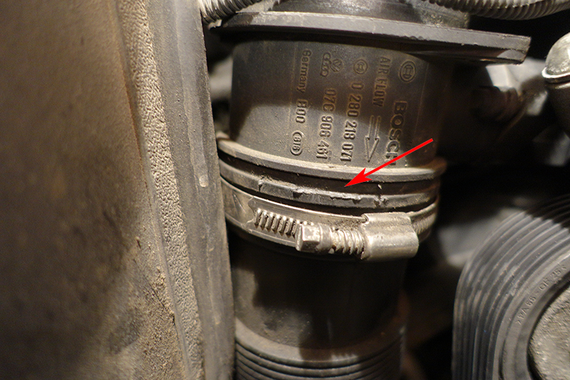

  5. Well, that could have gone better, but I guess it could have gone worse as well. It finally dawned on me to just do the passenger side first to see how these tubes come apart...I traditionally do the easiest side last. The MAF tube rotated as soon as it was unclamped, so there is in fact a problem with the driver’s side. I didn’t take the tube out on the passenger side, as it was easy to unscrew the sensor right there, and the whole side took about 15 minutes to do. For the driver’s side I gave up with the pipe, and used a chain of extensions and U joints on the ratchet to get the MAF out, 1/32 of a turn at a time. Cleaned both, but was a bit worried because in my efforts to get the tube loose, a few drops of WD40 had fallen into the mesh in the MAF tube. Cleaned it up the best I could and fired it up. I will take it out in the morning for a run, but I have that what have I done feeling about this – it was running OK before; still hard to start when cold and would get a bit shaky at idle after driving in traffic. But when I started it, it backfired out the driver’s side like crazy, gurgling and backfiring as I revved it. After warming up it got better, but now the idle dives down too low after letting up on the pedal. After cleaning do things have to re-train it somehow? If so do you turn PSM off for a while? I will see how it is after blowing it out tomorrow. There is also a definite oil leak somewhere on the left front region of the engine. Hard to get a good picture, but this is looking forward from the sway bar mount on the driver side. I really hope this runs better and not worse now!
  6. Failed...I don’t know what was up with the last people that worked on this vehicle. You mentioned it looked part way out already, but I haven’t moved it in the least. I think they couldn’t get it back together all the way and just forced it on the best they could. I have seen that theme with other work that was done on this e.g. all the plastic that was cracked and broken under the headliner that I saw when I did the hatch shocks. I think my only option is to remove it from the turbo end and get it onto a workbench. At least that should be plastic on steel.

  8. Thanks - so is it supposed to separate at the seam under the clamp? I used WD40 and tried for an hour to pull these apart and they won’t budge. I’m not used to working with plastic parts like this....trying to pry it apart and just gouging things up.
  9. Finally found a set of pentalobe security drivers with a TD25 in town and started on this. I was thinking these questions were kind of lame, but in case others search in the future thought it might be helpful for somebody. So my problem now is to get the drivers side MAF out without breaking anything. Although I can get to the screw holding the MAF in with extensions, kind of, this would be a lot easier if I could remove the air flow tube. Problem is I don’t want to torque on the housing, because the flex pipe that attaches it to the turbo underneath seems quite flimsy and the housing is really seized in there. But if you do separate them, is the arrow where they come apart? Second point is to get to the pentalobe screws holding the MAF in, it would be much easier to disconnect this line (arrow) This I assume (without a manual) is the upper rad hose - can I disconnect this when the engine is cool without draining some coolant out first? Or will it gush? A bit of an aside, with all this open I can see I do have an oil leak from somewhere under this area. Plus I think there is something else sub-optimal here; as I get used to the engine, I’m realizing I get better acceleration if I short shift it, due to the boost dropping off early. It peaks at maybe 4500 rpm, but then drops off fast after that. Will work on it more tomorrow. Cheers.
  10. Finally went to clean the MAF sensors; minor questions – to get out the air tubes holding these is easy on the normally aspirated engine, but the turbo sticks them down at the sides. Do people take out the whole air tube to do this, or just unscrew the sensor? Looks like getting to the inner bolt on the drivers side is a bit tight for room.... Passenger side is better Also, can you clean the pressure sensor with MAF cleaner as well? If not, just carb cleaner? Or not to bother? Also, if you unplug them (with the engine off...) do you have to reset any codes afterwards? I still don't have a OBD2 working yet, and will probably clean them attached if there is a risk of that. Thanks!
