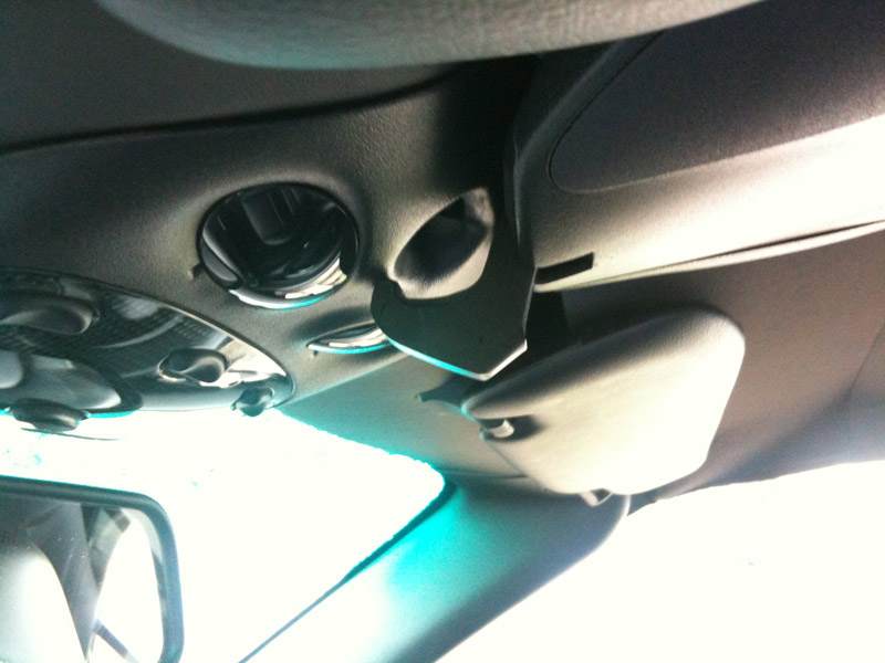

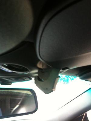

  6. Apparently there is a Porsche TSB for this - you just cut off a small piece of the plastic replacement and glue it on the latch. No dismantling is required.
  7. Hi! I just got the part and I am going to try and install it this weekend. Did you dismantle the latch mechanism? Was it easy? Any hints?

  9. Hi, I am looking for the part number for the plastic cover of the main latch for the convertible top of a 2003 996. You can see in the 2 photos the part I need - in one of the photos I have pulled the plastic off to separate it from the latch. Without the plastic cover, the latch does not fully press the switch and the top cannot complete the close sequence. Thanks, Michael
