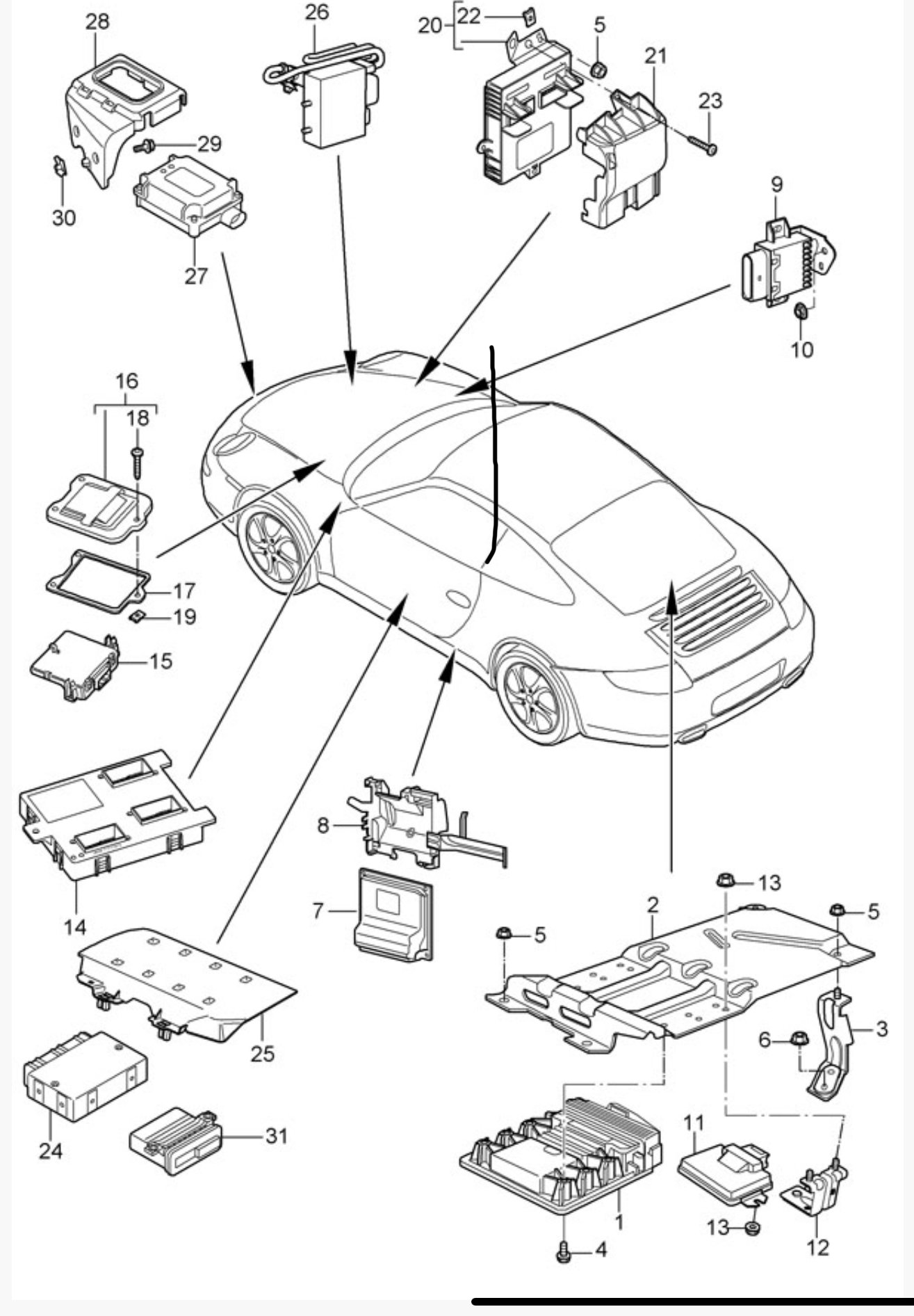

  3. Thanks for all your help, I hope we are getting close, do u have that Part # for the ABS/PSM unit?
  4. I have been searching the internet and I guess they meant the ECU / DME 997618607? Also what is 991 618 145?
