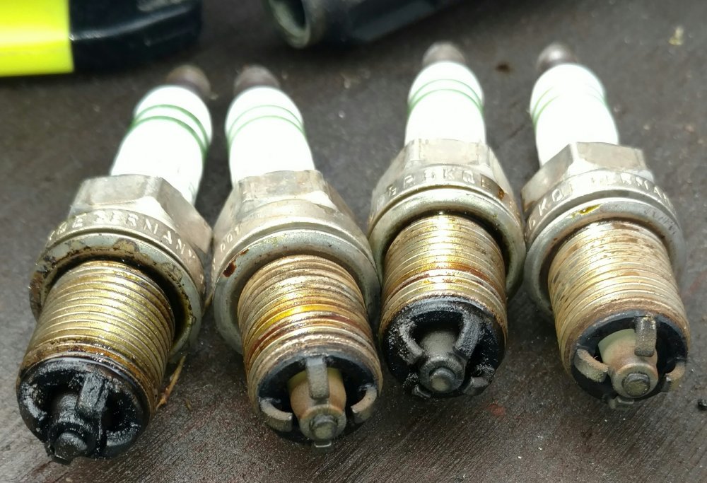

  2. I have icarsoft 960 reader... I get a lot of voltage related codes such as the ones I listed. The oil in the filler cap and as well as the filler cap is fine. This picture is driver's side plugs I.pulled out and then replaced. The right side of picture is the plug closest to front nose of engine. Will send passenger side next
  3. Wizard Coils look perfect ,no cracks or anything Plugs were pretty brown on ends, cylinders 1 and 8 were wet (smelled like gas)with large carbon deposits Cylinder 6 had carbon on plug also
