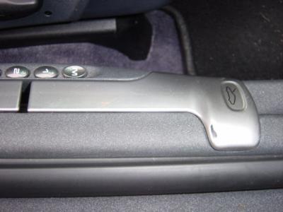

  14. Any suggestions on how best to repair scuff marks and damage to the trunk lever used on early 996s. I'm guilty of adding a couple but most appear after visits to the dealer but try convincing them of that. Clear contact film does help mask some of the marks and a silver adhesive dot covers the large one but I still see them each time I open the door. Thanks

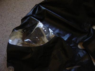

  15. Thanks for the info. on Speedlingerie, I have been talking to them but unfortunately they dont do one that covers the lights and the fenders. I agree though that they are the best looking of what I have seen. I will stick with my Aussie bra for now. I have used it for 4 years and I have had no damage. The one trip I did without it I got sprayed and the chips are [you guessed it] on top of the fenders.
  16. Your post arrived just in time, I had ordered a 2 pc bra but didn't realise that the lights were not covered until I read your message, you cant tell from the website photo. The locally made one I have has clear plastic panels that cover the lights and indicator lights. Without the plastic there must be a lot of dirt etc. that can get under the bra at that point.

  19. Thanks for the info. is there a website that shows details of the clear bra, I haven't seen them in Australia. Once installed is it always on or can it be removed. Bob, thanks for your input, I have a one piece bra which works Ok but you must remove it to get to the luggage. Is yours a Colgan from Pelican, if so how does the lower section attach around the luggage compartment. My car is ocean blue, shows marks very easily but so far its been ok with the bra, I always apply plenty of wax before I fit it.
