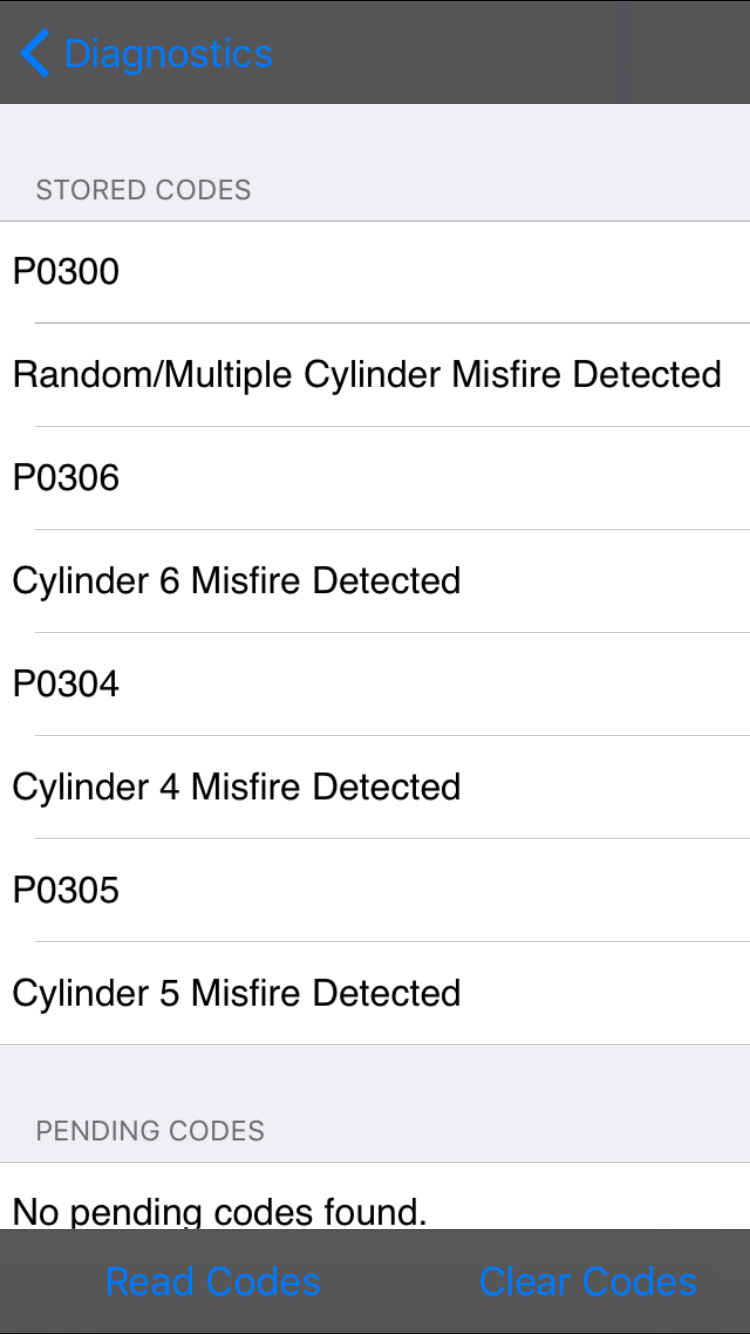

  1. Personally I don't think so, but will test it. But this is weird that it happens on the entire side (4-5-6).
  2. Coils – yes (all new). Wiring – that would be a good idea. Will try that, thx
  3. I actually already did that and they see exactly the same codes. We could see live how cyl 5 generates a lot of misfires. What's weird is there're really no other codes. (read with the original Porsche tester)
  4. The entire left bank misfires & the car runs rough. O2 replaced, MAF cleaned, new coils etc, no effects. All fuel injectors seem to be working ok (did a hearing test) Any ideas? And does anyone know what "Oxygen sensor heater" exactly is?
