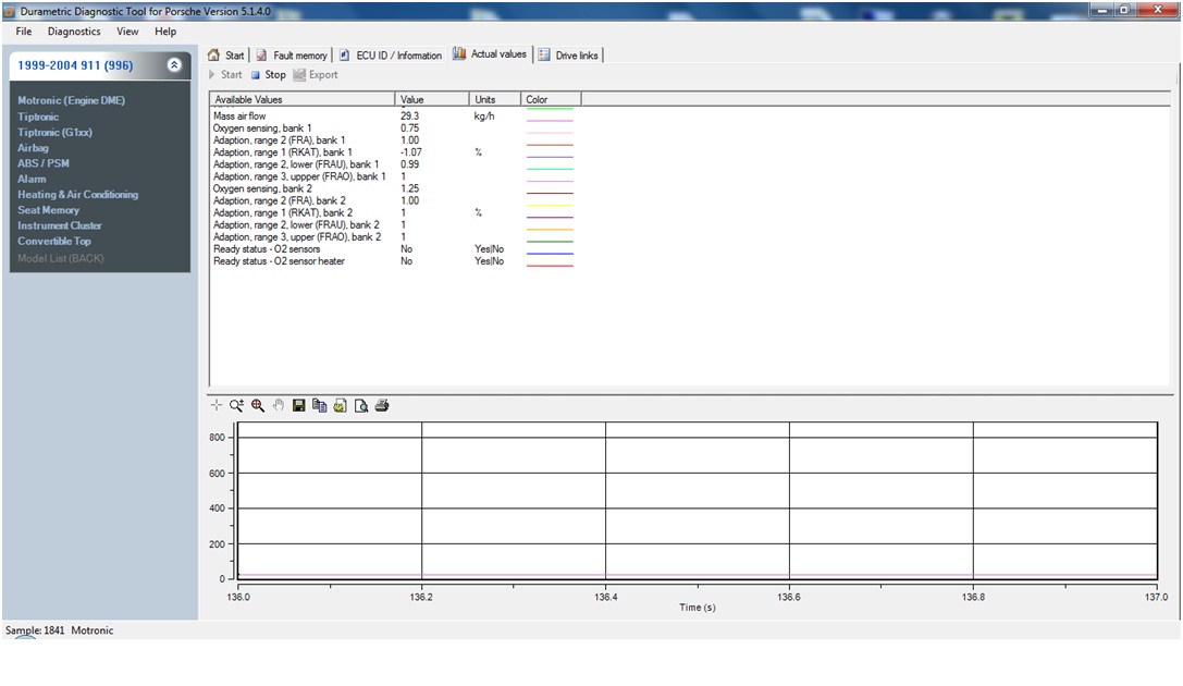

  4. It is and as far as i can follow the wire it looks ok. Any idea where does it end ? so i can run a trace. Thanks the MAF read arount 30kg/h at idle and goes to up around 90/100 at 3000 There is some more info on attached file Thanks

  7. Hi Engine was removed and put back in It is running fine cold but start running bad when it gets hot Got 4 Error code in DME 7.8.x - Engine Codes all related to Oxigen sensing adaption P1133 Factory Fault Code 358 - Oxygen sensing adaptation, lower load range, Bank 2 Below or above P1132 Factory Fault Code 359 - Oxygen sensing adaptation, upper load range, Bank 2 Below or above limit P1105 Factory Fault Code 357 - Oxygen sensing adaptation, upper load range, Bank 1 Below limit P1107 Factory Fault Code 356 - Oxygen sensing adaptation, lower load range, Bank 1 Below limit Dump from Durametric Already Checked all connectors Any idea welcome Thanks
